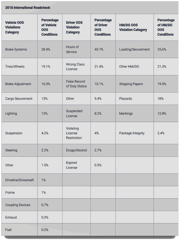

Of the North American Standard (NAS) Level I Inspections conducted, 21.6% of commercial motor vehicles were placed out of service. Of all NAS Level I, II and III Inspections, 3.9% of drivers inspected were placed out of service. In all, inspectors conducted 67,502 roadside inspections during the three-day blitz.
CVSA noted that there 3,035 driver out-of-service conditions observed and 15,981 vehicle out-of-service conditions. For drivers, the most common OOS was hours-of-service violations were for HOS violations, wrong class license (21.4%) and false Record of Duty status (10.1%). There were 729 safety belt violations as well.
Of the drivers operating vehicles carrying HM/DG who were inspected, 1.7% were placed out of service for driver violations.
Vehicles were most commonly placed out of service for brake system violations (28.4%), tires and wheels (19.1%) and brake adjustment violations (16.3%). Vehicles hauling hazardous materials or dangerous goods were placed out of service at a rate of 13.1%. Improper loading was the top violation for this group with 25.6% of vehicles being cited.
