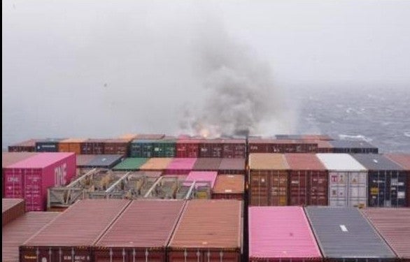

Germany’s Federal Bureau of Maritime Casualty Investigation (BSU) said last month that misdeclared coconut charcoal was the most likely source of the blaze on the Yantian Express, which caught fire in the Atlantic Ocean on Jan. 3, 2019.
Fire erupted in the fore ship of the Yantian Express. (Photo: Hapag-Lloyd)

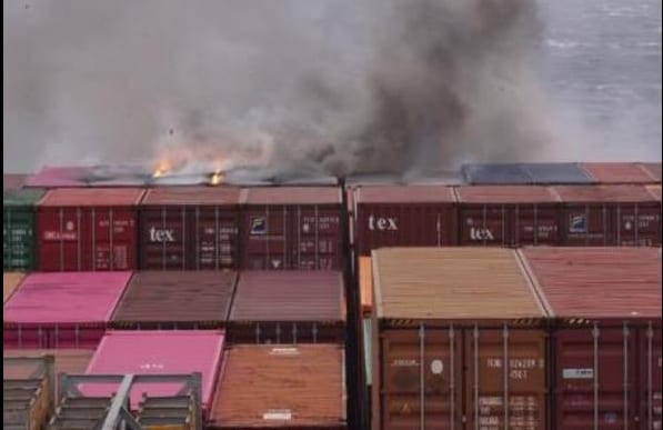

The Yantian Express fire broke out in a container stowed on the deck of the German-flagged vessel while the ship was en route to Halifax, Nova Scotia. The Hapag-Lloyd container ship began its westbound voyage in Vung Tau, Vietnam, and berthed in Singapore and Sri Lanka before sailing for Halifax.

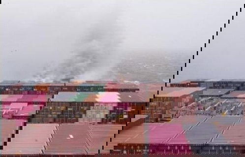

The fire was discovered in the early-morning hours of Jan. 3.

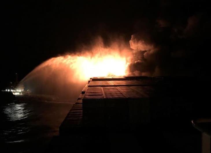

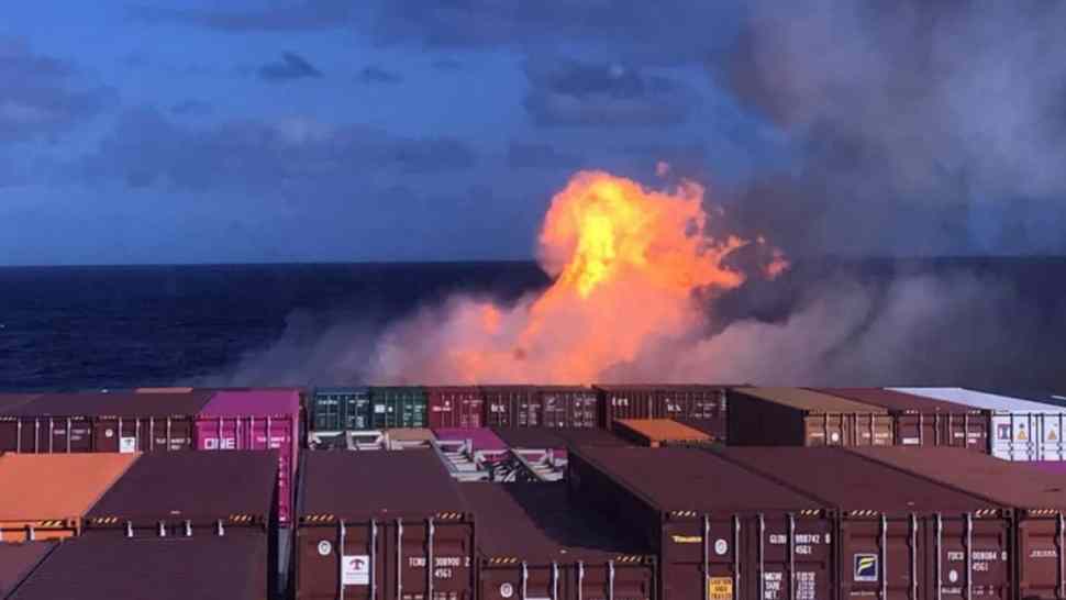

“Despite all efforts, the fire developed further at about midnight due to the increase in the wind, amongst other things. Furthermore, the water jet failed to reach the third tier due to the strong wind. In addition, the supply of compressed air was almost exhausted after some 24 hours. Fighting the fire under such circumstances was deemed perilous by the master and the crew was withdrawn for their safety.”
The crew gathered in a conference room, where they were told of an approaching vessel, the ironically named Happy Ranger. “The ship’s command regarded the fire as ‘out of control’ at this point in time,” the report said.
The Yantian Express crew fought the fire in bay 12. (Photo: Hapag-Lloyd)

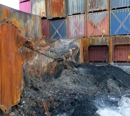

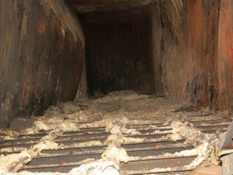

The floor of the container at slot 120382 was completely burned. (Photo: BSU)

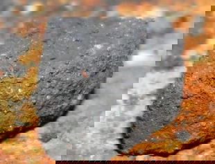

Page 46 of the BSU report states, “Coconut charcoal rather than the coconut pellets specified in the cargo documents was in container UACU5272502 at slot 120782. The difference between coconut pellets and the pyrochar … is clear. Coconut pellets are produced by grinding coconut shells and used as fuel for furnaces. … Chemically, coconut pellets are completely different from coconut charcoal.

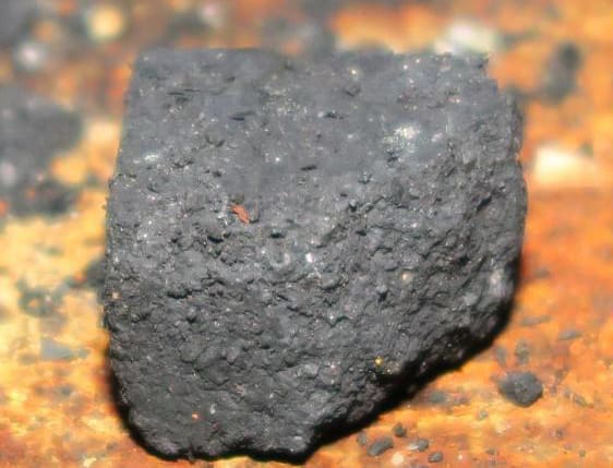

Coconut charcoal cubes were found. (Photo: BSU)
“Pyrochar or vegetable char, produced by means of coconut shell pyrolysis, have properties comparable to wood-based charcoal,” it said.

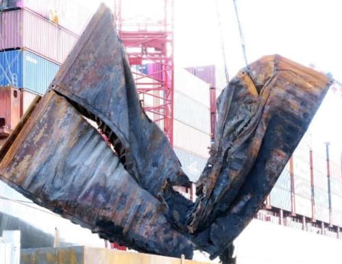

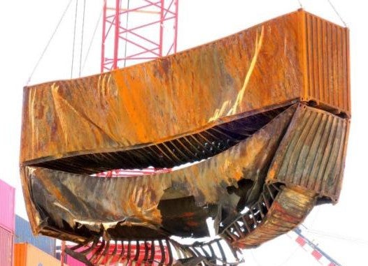

Containers at slots 120784 and 120782 were nearly unrecognizable. (Photo: BSU)
“This was one container. Everything in front of the bridge house was burned down. This is simply ridiculous. Again and again it’s always the same patterns, always the same causes. It is, in our view, highly avoidable. We would not only save vessels, we would also make the journey much, much safer for the seafarers on board,” Lange said.

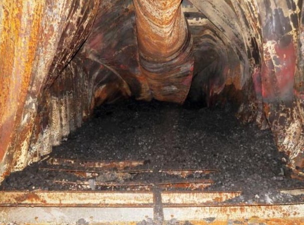

Unburned pyrochar spilled out of the container at slot 120782. (Photo: BSU)
