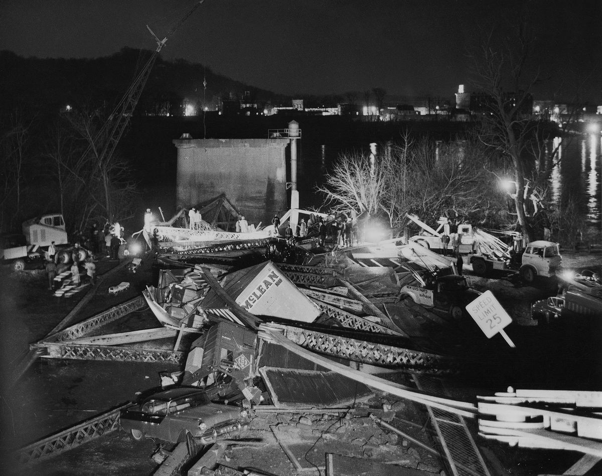

Collapse of the Silver Bridge at Point Pleasant, W. Va. Dec. 15, 1967. (Photo: Herald Dispatch and the Huntington Advertiser/Associated Press)

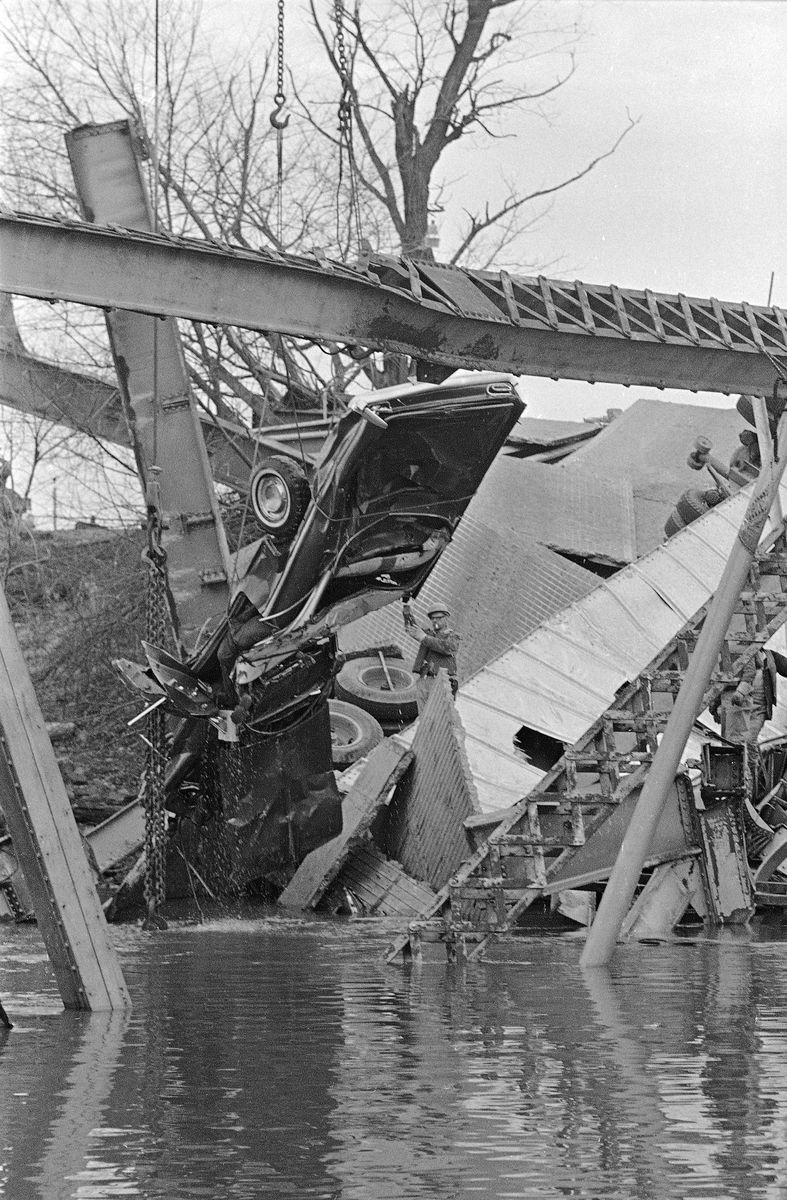

A workman signals a crane as it removes wreckage from the Ohio Silver Bridge that collapsed Dec. 15, 1967 sending vehicles to the water below. (Photo: Associated Press)
