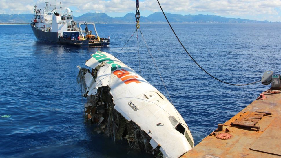

The forward section of the fuselage of Transair Flight 810 was recovered from the Pacific Ocean on Oct. 20, 2021, about two miles from shore near Honolulu. The freighter crashed after the flight crew reported engine problems soon after departing the Honolulu airport. (Photo: NTSB/Clink Crookshanks)
