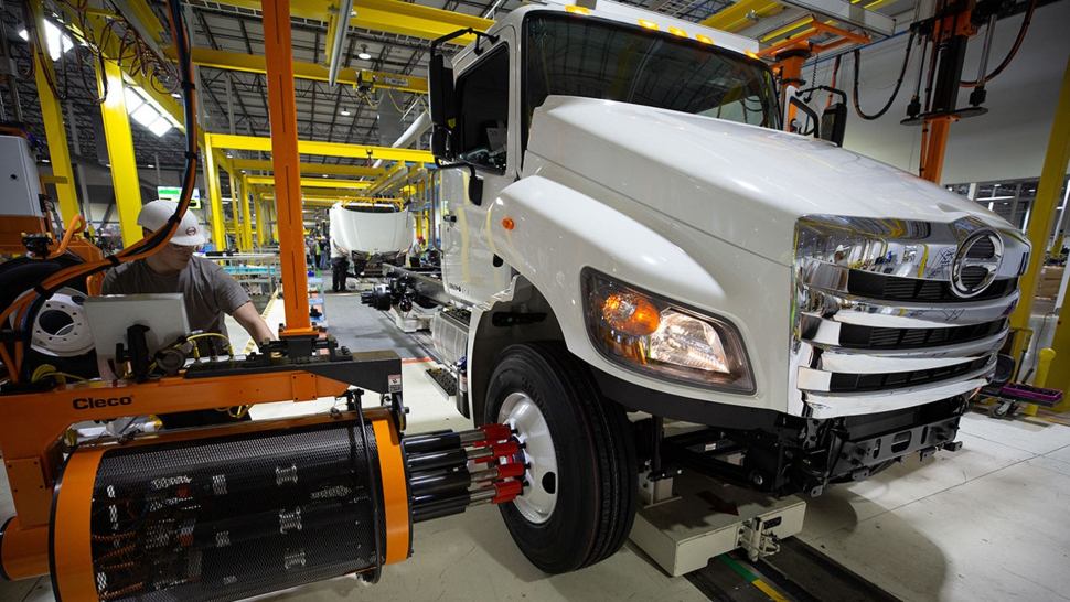

The U.S. arm of Japan's Hino Motors Ltd. is recalling 8.025 trucks because of inaccurate fuel readings. (Photo: Hino Motors)
