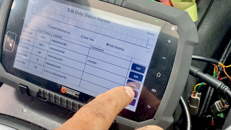

But his most troubling allegation came from a test he subsequently performed with a passenger vehicle. (Dhaliwal says he didn’t use his brother’s truck because he didn’t want to deprive him of a load.) In the video, which he shared with Transport Canada officials and subsequently FreightWaves, he claims to shorten his driving time by 17 minutes.
How Dhaliwal claims he tested and cheated the Guardian ELOG
1. Ordered a device via friend and connected it to a passenger car
2. Set the ELD into manual drive mode
3. Removed the driving record and replaced it as time spent in the sleeper berth
“If I can shorten this drive time, I’m laughing, I’m one of the best drivers you can possibly hire,” he says in the video.
In the video, he claims to edit driving time that should have been automatically recorded by the ELD. Instead, he reclassifies it as being in the sleeper berth. While Canadian ELD standards do allow for some edits and amendments to driving records, they state that devices cannot allow for the reduction of driving time once it is automatically recorded.
“So I have gained 17 minutes of driving time, so this does allow driving time to be shortened — automatic driving time to be shortened,” he says near the end of the video. “So there you go. I have done my part. Now I’m good to cheat.”
That restriction represents a key — if not sacrosanct — provision in the Canadian ELD standards. ELDs are required to automatically record driving time when a vehicle is in motion unless the duty status has changed to off duty, or set for yard moves. The ability to reduce that driving time would allow for drivers or their carriers to misrepresent their hours of service.

Diesel Tech challenges Dhaliwal’s contention that the video shows him editing down his automatically recorded driving time. The company notes that one of the steps he takes in the video — manually changing the ELD’s status to driving mode — meant that the record generated was deemed a manual entry, something that is allowed to be edited.
But the company’s argument is narrow and does not directly dispute that Dhaliwal appears to be demonstrating log falsification. The company argues that what is shown in the video represented use that was not foreseen in the government’s official testing protocol, which the ELD certifying bodies are required to follow.
“This specific scenario is not covered in the provision of the Test Procedure from TC, while the user manually sets himself to ‘Driving’ and starts moving the vehicle,” the company wrote. “This is a valuable scenario that should be considered, but it will be more official if TC could add this provision into their Test Procedure.”
A copy of the official test procedures obtained by FreightWaves does not appear to explicitly lay out what Dhaliwal did in his test. But Dhaliwal maintains that the driving he demonstrated in the video should have been captured as automatic driving regardless, and thus making it impossible for him to shorten it.
“This is an obvious test,” he said.
