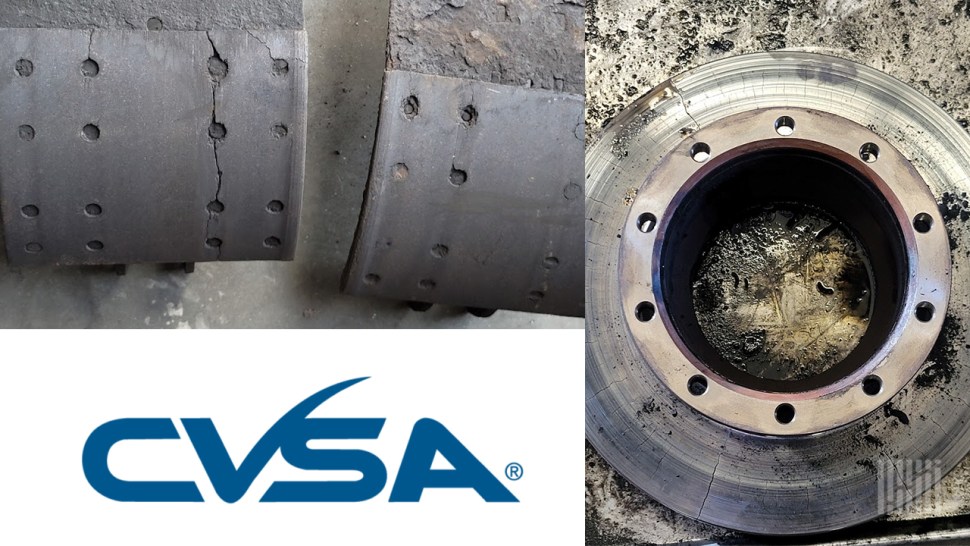

This year’s focus on drums and rotors revealed 113 violations, with 39 vehicles placed OOS specifically for rotor or drum defects. The breakdown: 22 broken rotors on air disc brakes, 50 rusted rotors, 32 broken drums on S-cam brakes, plus multiple hydraulic system failures.
Broken rotors. Rusted rotors. Broken drums. These aren’t components that suddenly failed without warning. These deteriorated over time while someone, a driver, a mechanic, a fleet manager, looked them over during inspections and decided they were good enough to keep rolling.
