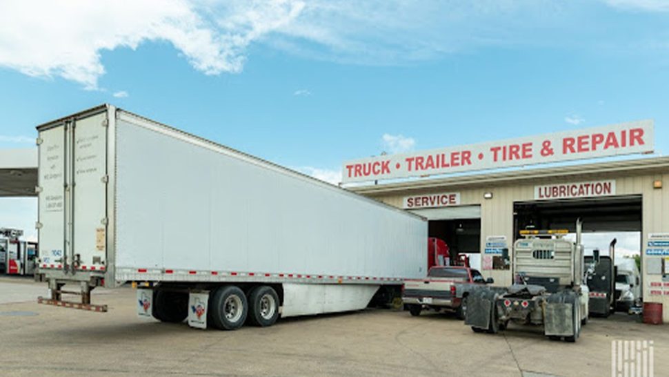

(Photo: Jim Allen/FreightWaves. Miss one maintenance interval, and this is where you end up. Small carriers can’t afford surprise downtime — syncing your OEM schedule into your ELD keeps the truck rolling and the revenue coming.)
