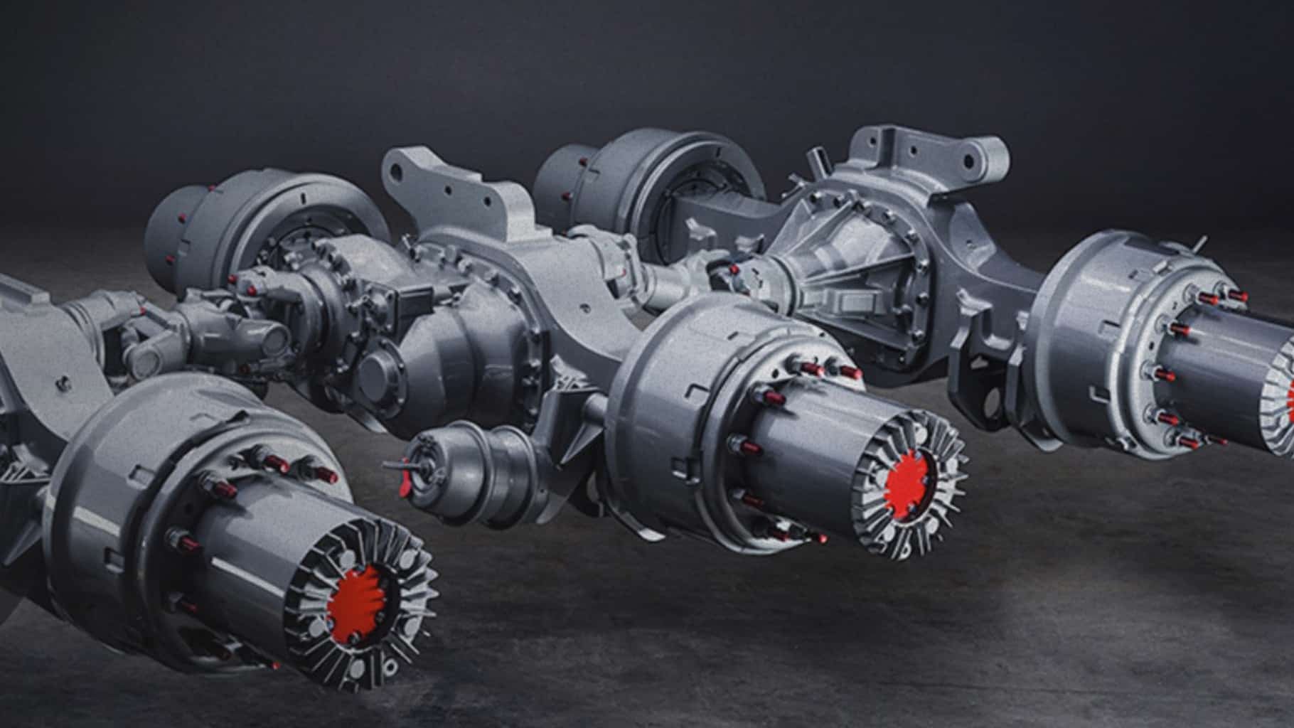

Supplier Meritor Inc. (NYSE: MTOR) is responsible for the issue. Daimler Trucks North America (OTC: DMLRY) has 1,040 trucks affected by defect notice 19E-036 filed by Meritor in May for its MX14-120 EVO axle assemblies. The affected assemblies were built from Dec. 31, 2018 through May 13 at its Laurinburg, North Carolina facility.
Assembling the axle without oil in the wheel end can result in the bearings overheating. That can lead to damage and/or seizing of bearings and plastic deformation of components. Eventually, the wheel end can separate from the axle, leading to a crash.
Meritor Inc. allowed some axle assemblies to leave a North Carolina plant with insufficient lubrication.
A driver may hear an unusual noise or feel vibration or pulling of the steering wheel, Meritor said. Navistar said a driver also might see smoke from the underside of the vehicle.
