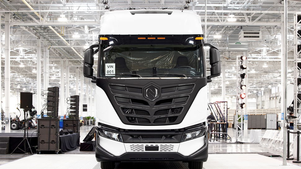

Nikola is recalling all the trucks it has built so far because of a seat belt defect. (Photo: Alan Adler/FreightWaves)
