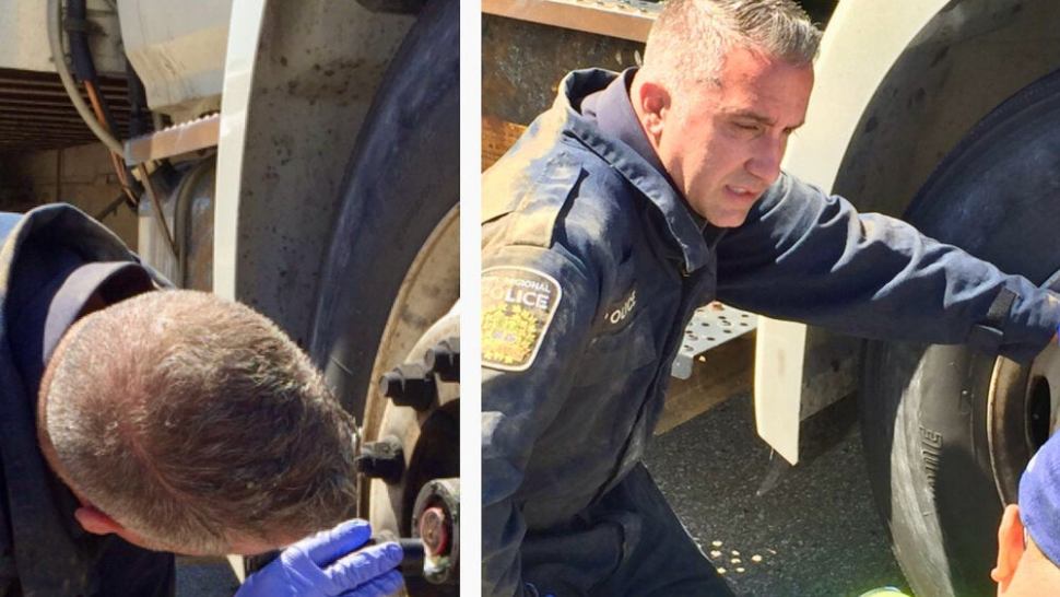

Being a police officer wasn’t Parmigiano’s first career. He worked as an auto technician — an experience that helps him on the job as he patrols Peel’s roads. His top priority is identifying issues that pose safety issues for the drivers themselves and the general public.
It starts with a basic visual inspection while he’s driving his patrol vehicle — looking for obvious things like tire and light issues.
“I’m actually looking for defects while I’m driving by the vehicle,” he said. “Sometimes it’s hard when you’re on the road and you’re doing 60 kilometers per hour (37 mph), and you’re trying to see if there’s tread on the actual tires.”
While officers like Parmigiano receive specialized training to inspect commercial trucks — and are trained regularly — he also brings a gearhead sensibility to the work.
“I’ve been doing it so long that I’m using all of my senses — my hearing, my sight — when it comes to commercial motor vehicles,” Parmigiano said. “Because of my background, looking at a tire, I can gauge whether there’s enough tread on it or not, or if there’s some other kind of defect like air leaks from the glandhand section of the truck, or from the actual brake chambers, as we’re slowing down at an intersection.”
When it’s bad, the truck is taken out of service. The most common reason: tires.
“I’ve come across a lot of tires that have zero tread or they actually have cords or visible steel belts popping out of them,” he said.
