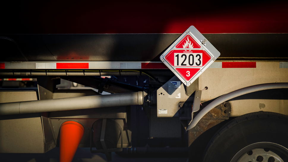

For example, both the flammable gas and flammable liquid labels are red diamonds marked with a white flame. Some placards may have “flammable gas” or “flammable liquid” scripted on the sign, but that’s not always the case. Barlar said to remember that flammable gas placards are marked by the number 2, flammable liquids by the number 3. The Federal Motor Carrier Safety Administration outlines hazardous materials labeling here.
In addition, placards or the trailer itself may be marked by a four-digit UN/NA number, which designates a certain hazardous chemical or group of hazardous chemicals. It’s important to have this number in addition to the correct placard. Barlar explained, “1203 is the number specifically for gasoline. But if you just had a class three [flammable liquid] placard on the vehicle, it isn’t telling you that it’s specifically gasoline, just a flammable liquid; 1203 it’s telling you what type of material it is.”
He noted that one of the first things inspectors look for is the placard and its identifiers. It’s crucial that drivers have the appropriate labels displayed not just to avoid a violation, but also to ensure that emergency responders know how to respond in the event of a tanker leak or spill.
