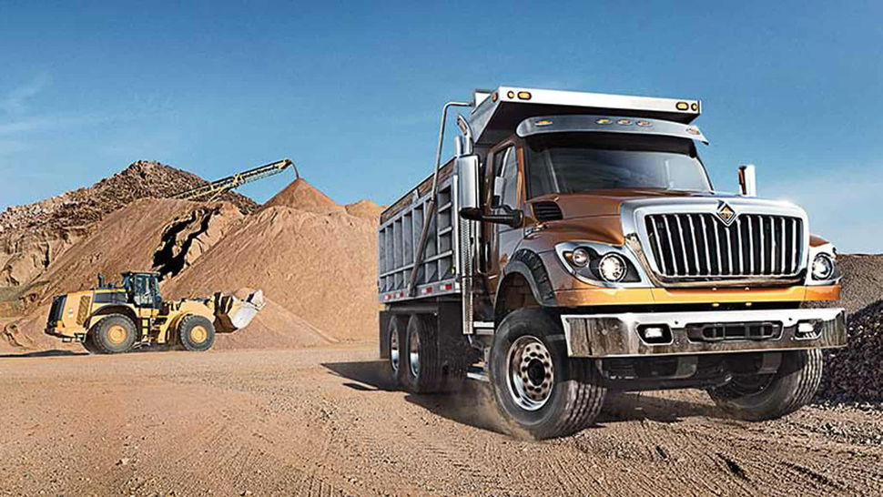

Navistar is recalling nearly 45,000 older trucks because an electrical issue can lead to fires. (Photo: Navistar)
