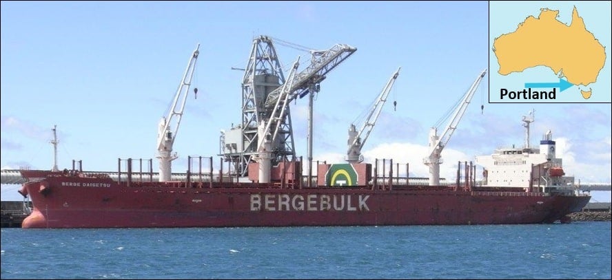

Pictured: the Berge Daisetsu; inset: a map of Australia showing the location of the accident. Picture/graphic: Australian Transport Safety Bureau
A job painting the walls of a ship’s hold aboard an ocean-going dry bulker very nearly resulted in the deaths of two crewmen who, by luck only, were thrown to their knees instead of pitched to the floor, over 30 feet below, when their improvised work platform failed.
According to an official accident investigation report from the Australian Transport Safety Bureau (ATSB), a six-member team had been tasked with cleaning and painting the holds of the log carrier/dry bulker Berge Daisetsu (IMO 9713179), at the port of Portland, Victoria.

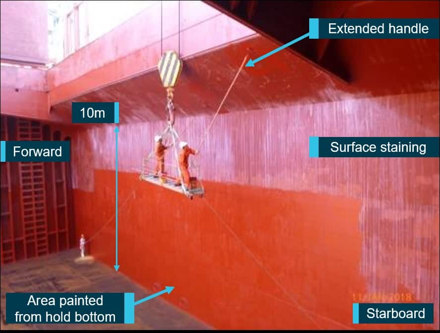

So the crew took a portable gangway, tied some ropes to it, hooked up a ship’s crane and lowered the whole assembly, with two men, long-handled brushes, and 20-liter paint buckets onboard, into the hold to paint the walls.
The gangway had been supplied to the ship to grant safe access to and from the vessel. It was never intended to be used as a mobile platform for working at height.
“Because the improvised arrangement had limited stability, the ABs [able-bodied seafarers] stood one at each end of the staging to balance it. They were to work from these positions and limit their movement so as to not upset the staging and equipment on board,” the report reads.
There were also two further seafarers down on the floor of the hold. They were holding ropes  attached the gangway/work platform to keep the whole apparatus from swinging around too much.
This picture was taken by the master of the Berge Daisetsu of the actual crew carrying out painting work prior to the near-fatal accident. Annotations have been added by the Australian Transport Safety Bureau.
