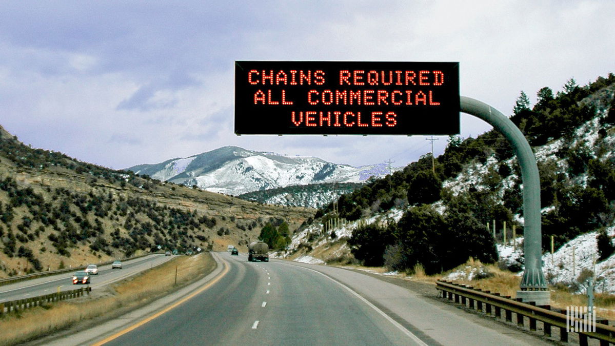

Certain states require commercial truck drivers to carry chains during certain times of the year, even if the weather is clear. This is because conditions can change quickly in some areas, especially with elevation. Chains are more commonly used in the western and northern U.S. than other regions.
Related: 5 states with toughest chain laws for truckers
Since snow is more likely to occur in mountainous terrain, that’s where most laws require that chains be used. However, laws vary by state and Canadian province regarding types of chains permitted, how many tires must be chained, etc. Truckers should become familiar with these chain laws to stay safe and avoid fines.

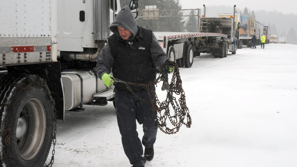

There’s no specific process or only one right way for installing chains. Drivers should find what works for them. However, many of them, including Smart Trucking’s Catherine MacMillan, have found it best to lay the chains out alongside each tire, checking for damage or kinks. Damaged chains will put drivers in violation of many chain laws and improper installation will cause damage.
(Photo: Shutterstock)
Then drape the chains over each tire, tucking the front-of-the-truck side under the tire. Pulling the truck forward 2 feet should give drivers enough slack to complete the chain-up on all the tires without moving the truck again. Drivers often use bungee cords on each tire, placing them at the 12 to 6 o’clock, 2 to 8 o’clock, and 4 to 10 o’clock positions.
