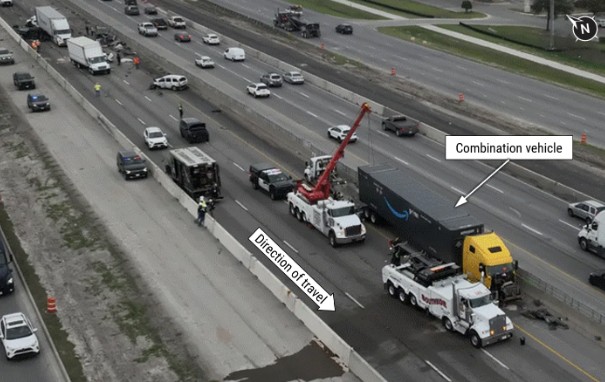

​Aerial view of the crash site on I-35 showed the semitruck stopped along with other wrecked vehicles. (Photo: Austin Police Department, NTSB)
The truck rear-ended a 2013 Volkswagen Jetta passenger car and a 2006 Chevrolet Silverado pickup truck. It continued another 0.1 miles, causing a pileup of 13 more vehicles before coming to a stop on the left shoulder of the road, NTSB said.
The report stated I-35 has six lanes – three northbound and three southbound – at this location. Just over 2 miles of short-term road work was underway when the incident occurred, and the speed limit was lowered from 70 mph to 60 mph along this section.
“As a result of the crash, all four occupants in the passenger car and one passenger in the pickup truck were fatally injured,” the report stated. “The other two occupants of the pickup truck and the other occupants in the crash-involved vehicles reported various injuries ranging from minor to serious. The driver of the combination vehicle was uninjured.”
