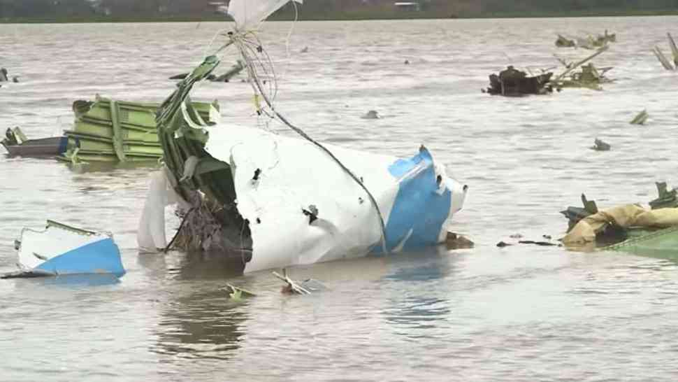

Debris from an Amazon Air cargo plane scattered across a swamp in Trinity Bay, Texas., Feb. 23, 2019. The NTSB says pilot error is the probable cause of the accident, but other factors played a role. (Photo: NTSB)

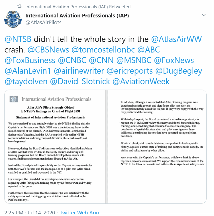

The union representing pilots at all-cargo carrier Atlas Air (NASDAQ: AAWW) strenuously objected to investigators’ findings that mistakes by the captain contributed to a deadly crash last year, blaming the company and aviation regulators for allegedly letting an unqualified co-pilot fly commercial aircraft.
A National Transportation Safety Board draft report this week attributed the accident’s probable cause to errors by the first officer in response to inadvertent activation of a switch that aborted the plane’s automated descent. The co-pilot, confused into thinking the Boeing 767-300 converted freighter was stalling, pitched it into a nosedive. Investigators said the pilot was distracted by other duties and failed to adequately monitor the flight path and quickly assume control of the aircraft.

During a hearing to discuss the staff report, NTSB members “identified problems at Atlas Air that were evident in the safety culture and hiring and training programs, but the Board did not develop those issues into causes, findings or recommendations directed at Atlas Air,” Teamster’ Local 2750 said in a statement posted on Twitter. “Instead the Board placed responsibility on the captain to compensate for both the FAA’s failures and the inadequacies of a pilot that Atlas hired, certified as qualified and type rated in the [Boeing] 767.”
