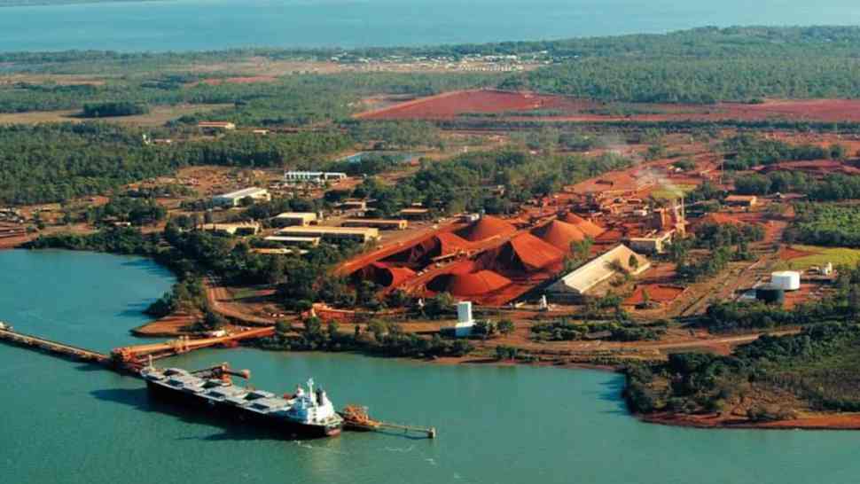

Pictured: an aerial view of the Port of Weipa; Photo: North Queensland Bulk Ports - Port of Weipa Land Use Plan
