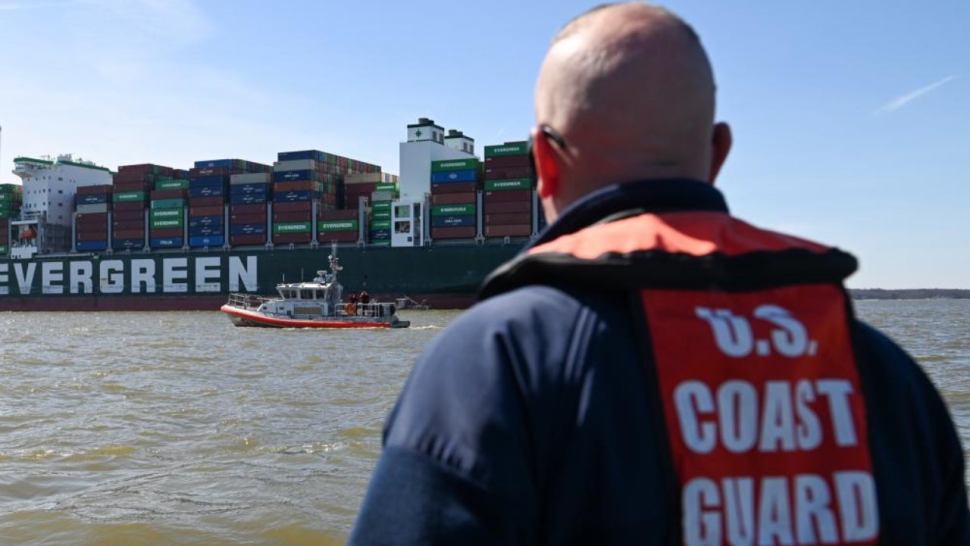

A Coast Guard crew monitors the container ship Ever Forward, which ran aground in Chesapeake Bay on March 13. (Photo: Petty Officer 3rd Class Kimberly Reaves/Coast Guard)
