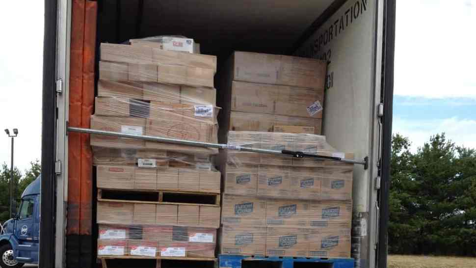

  • Dry vans trailers: 44,000 to 45,000 pounds
  • Refrigerated trailers or reefers: 42,500 to 44000 pounds.
The reason for the different payloads across the three most common trailer types is the weight of the trailer. Flatbed trailers are usually made of aluminum and as such are very light offering the highest possible payload within the 80,000-pound maximum limit. Dry vans have more to them including a fiberglass body on top of the trailer adding weight and reducing the payload by a few thousand pounds. Refrigerated trailers are even heavier than dry vans as they require insulation inside the fiberglass walls to keep freight cool or frozen plus they have to carry a massive refrigeration motor on the front of the trailer and an extra diesel tank under the trailer.
