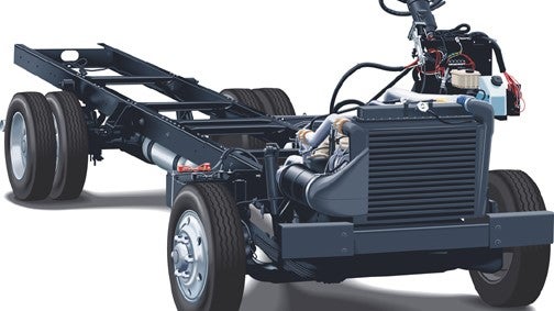

Freightliner Custom Chassis Corp. is conducting a third recall of eight products because of a faulty power distribution module that affects lighting on the vehicles. (Photo: Freightliner Custom Chassis Corp.)
