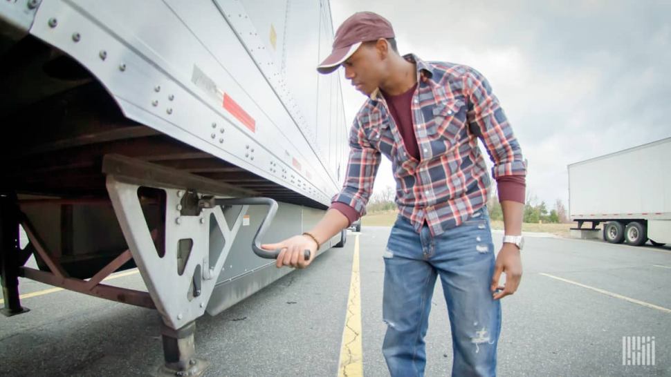

Raising and lowering the landing gear
Drivers should always use three points of contact when handling the trailer’s landing gear. The rule is simple: Always maintain two hands and a foot or two feet and a hand on the truck when climbing its steps or ladder.
You should already know the basics, but remember to stand parallel to the trailer with one hand cranking the handle and the other braced firmly on the trailer.
“It’s not going to save you much time to sit there and spin the handle,” Runnels said. “I’ve done so in the past but stopped after I took a handle to the chin. It hurts — a lot.”
As an additional tip, Runnels advises drivers to wiggle the handle before use, especially after it rains. This will rid the handle of excess water that might’ve built up over the trip. This prevents drivers from splashing themselves with dirty, rusty water when spinning the handle.
