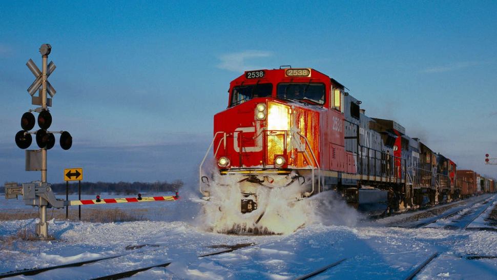

Ice by the train tracks led to a February 2020 derailment of a CN crude train. (Photo: CN)
