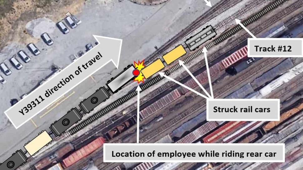

The National Transportation Safety Board (NTSB) is investigating a fatal October incident at CSX's rail yard in Richmond, Virginia. (Photo: NTSB)

According to the findings, which NTSB said are subject to change as it continues its investigation, the CSX employee was riding alone on the outside platform of CSX train Y39311 and operating the train by remote control. The train consisted of one locomotive and 18 railcars.
At 2:17 a.m., the CSX employee was operating the train in reverse and was in the process of shoving, or moving, the railcars down the yard lead when the train struck the northeast corner of one of three railcars that were positioned in track 12, NTSB said. The train appeared to be traveling at 4 mph, and it was dark and rainy when the accident occurred. The outside temperature was 65 degrees.
