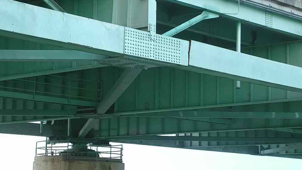

Crack in I-40 bridge that connects Arkansas and Tennessee. (Photo: ARDOT)

Arkansas Department of Transportation (ARDOT) Director Lorie Tudor told the Associated Press there was a “significant fracture” in one of two 900-foot horizontal steel beams that are crucial for the bridge’s integrity.
“This fracture had the potential of becoming a catastrophic event that was prevented by our staff’s diligent effort in managing our bridge inspection program,” Tudor said.
ARDOT tweeted that it found the crack during a routine inspection of the bridge over the Mississippi River, connecting Memphis, Tennessee, to West Memphis, Arkansas. The department said it was working with the Tennessee Department of Transportation (TDOT) to ensure the bridge, known as the Hernando de Soto Bridge, is safe before reopening.
TDOT said the crack was found in the bottom side of the bridge truss. ARDOT spokesman Dave Parker told the AP that drones were being used to take a closer look at the crack.
