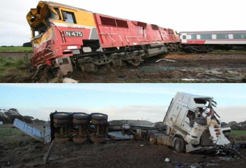

Locomotive and truck were both flung into empty fields by the force of impact after smashing together on a level crossing. Both photos: Chief Investigator, Transport Safety (Vic).

Passenger train smashed into semi-trailer because of restricted vision
A lack of clear lines of sight was the fundamental reason why a passenger train smashed into a semi-trailer at 59 miles per hour on July 13, 2016, injuring 21 people. The train driver and the truck driver were both hurt. Thankfully, there were no deaths.
A recently released report by the Australian Transport Safety Bureau (ATSB), which is tasked with investigating aviation, maritime and rail accidents, concluded that the truck driver entered the level crossing in the Australian state of Victoria unaware that a nearby train was approaching.
He couldn’t see the train because the view along the track to the left was restricted by an acute road-to-rail angle. Controls available to the local authorities to manage the risk were not used by either the train operator or the local council. The interaction between the two bodies in tackling the risk was also ineffective.
The ATSB also concluded that more than 100 level crossing in Victoria were non-compliant with safety standards because of acute road-to-rail angles that affected the ability of truck drivers to see approaching trains.
On the day of the accident, the truck was hauling 26.5 metric tonnes (29.2 U.S. tons) of bulk stock feed in a prime mover/semi-trailer configuration. The train carried 99 passengers. Both vehicles were fitted with data-logging devices.
The train began sounding its horn about 1,700 feet away on its approach to the level crossing; the train driver later reported he had seen the truck through a row of trees. The truck stopped a short distance before the crossing. It waited for three seconds. The truck started up. It moved onto the crossing. The train was less than 722 feet away. The train driver hit the emergency brakes. The truck’s prime mover cleared the crossing. The trailer had not.
The train smashed into the trailer at 59 miles an hour.
The locomotive derailed but stayed upright. The trailer/truck jackknifed and was flung into a nearby field. The trailer rolled over and was completely smashed. The front left-side of the prime mover’s cab was utterly destroyed.
