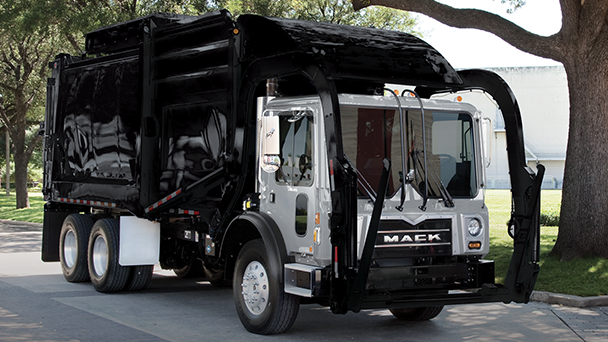

Mack Trucks is recalling TerraPro refuse trucks from 2008-2022 because the parking brake can fail and lead to a rollaway. (Photo: Mack Trucks)
