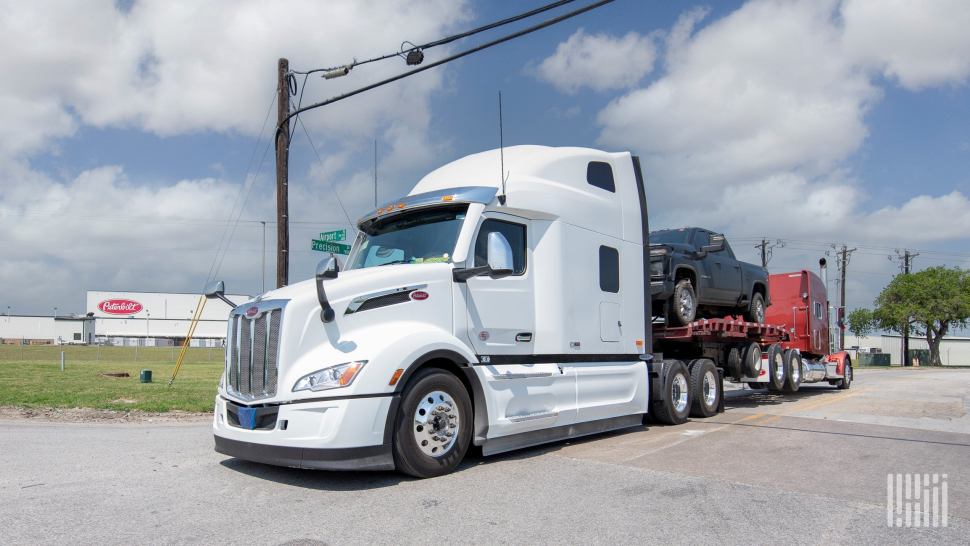

Paccar Inc. is recalling 4,914 Peterbilt Model 579 Class 8 tractors that have experienced six under hood fires. A misplaced fastener can chafe alternator cable insulation. No injuries or deaths have resulted.
On certain Model 579 trucks equipped with a Paccar MX-13 engine and Paccar 160-amp alternator, the alternator positive cable may chafe against the left-hand side front spring bracket top rearward fastener. The head of fastener may be outside of the frame rail.
