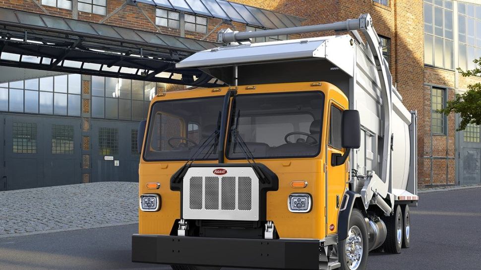

Paccar Inc. is recalling 16,033 Peterbilt Model 320 and Model 350 refuse trucks because of an axle bracket issue. (Photo: Peterbilt)
