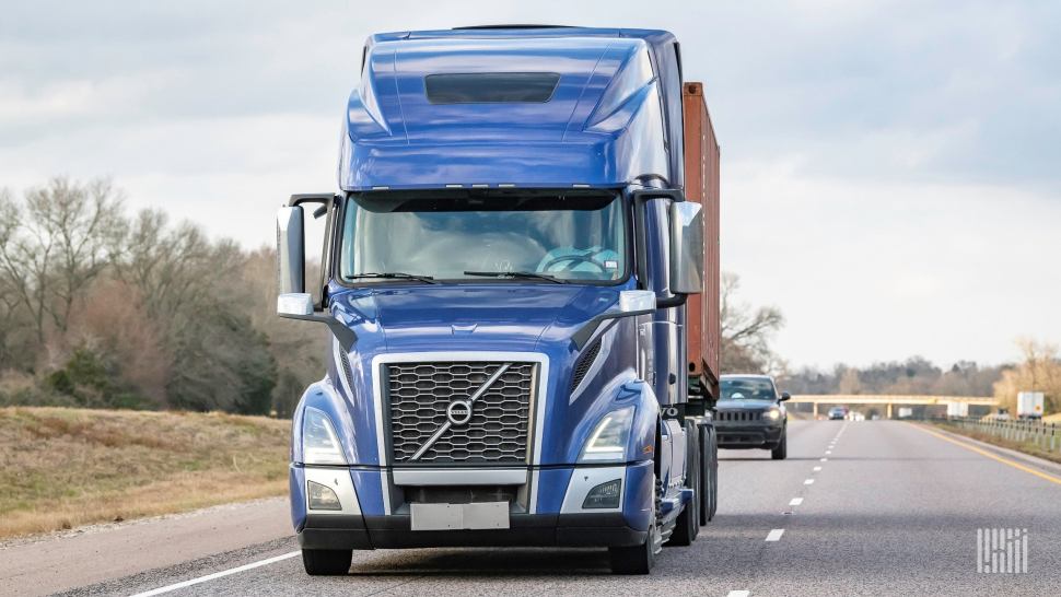

Volvo Trucks North America is recalling 63,095 vehicles in the U.S. and Canada because the windshield wiper motor may fail. (Photo: Jim Allen/FreightWaves)
