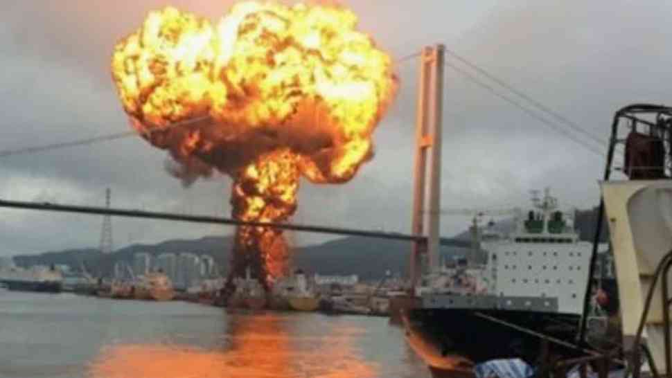

A massive explosion aboard a chemical tanker blew a fireball and mushroom cloud into the sky over the weekend at the Port of Ulsan, South Korea. Local reports indicate that about 18 people were injured primarily from burns and smoke inhalation. One ship has likely been rendered inoperable and another has sustained heavy damage.
An explosion in one of the cargo tanks of the Stolt Groenland (IMO 9414072) took place at the Port of Ulsan, about 197 miles south east of the South Korean capital, Seoul, at 11:00 local time on Saturday, September 28. The ship subsequently caught fire and burned for another 18 hours until about 05:30 a.m. the following day.
The ship was moored at the Yeompo Quay on the Dong-gu (east side) of the Taehwa River next to the Ulsan Bridge. Amateur video recorded by motorists shows how the fireball exploded into the air.

Pictured: the Stolt Groenland, right with the yellow hull, sends a column of fire and toxic smoke skywards in Ulsan. The smaller vessel, left with the red hull, is the Bow Dalian. Photo: unknown amateur photographer.
