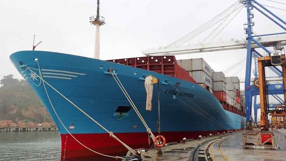

The Leda Maersk
According to VesselTracking.net, the Leda Maersk (IMO 9190755) is a 265.84-meter long by 37.4-meter wide (872.12 feet by 122.7 feet) fully cellular container ship with a draught (the underwater part of the hull) of 14.02 meters (46 feet). It has a container capacity of 4,045 twenty foot equivalent units (TEU), of which 1,109 are refrigerated. The Denmark-flagged Leda Maersk is owned by Maersk Line and it was built in 2001.
