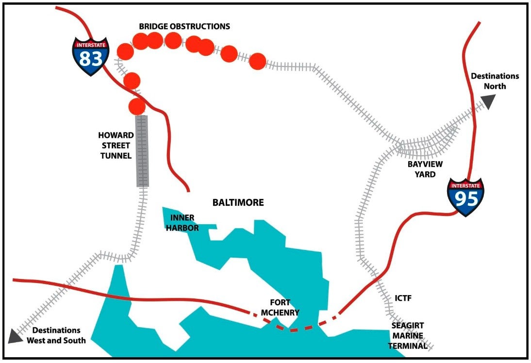

The four-arch North Avenue stone bridge — just north of the north tunnel portal — spans CSX, Amtrak and Baltimore light rail tracks, as well as Jones Falls. Overlapping infrastructure in the compact area complicates matters: The CSX main line sits atop Amtrak’s B&P Tunnel.
“It’s a very interesting structure. It’s the location where the Amtrak B&P Tunnel comes underneath us,” Knapp said. “We actually sit essentially on a bridge over top of their tunnel, and then we have North Avenue over the top of us.”
That, of course, meant that the only way to gain clearance was to go up. CSX is replacing one of the stone arches with a steel girder span. Clearance work is wrapping up at Guilford Avenue, while the Harford Avenue and North Avenue projects aren’t expected to be completed until early 2026.
“We’re doing our best right now to help accelerate that schedule,” Knapp said.
