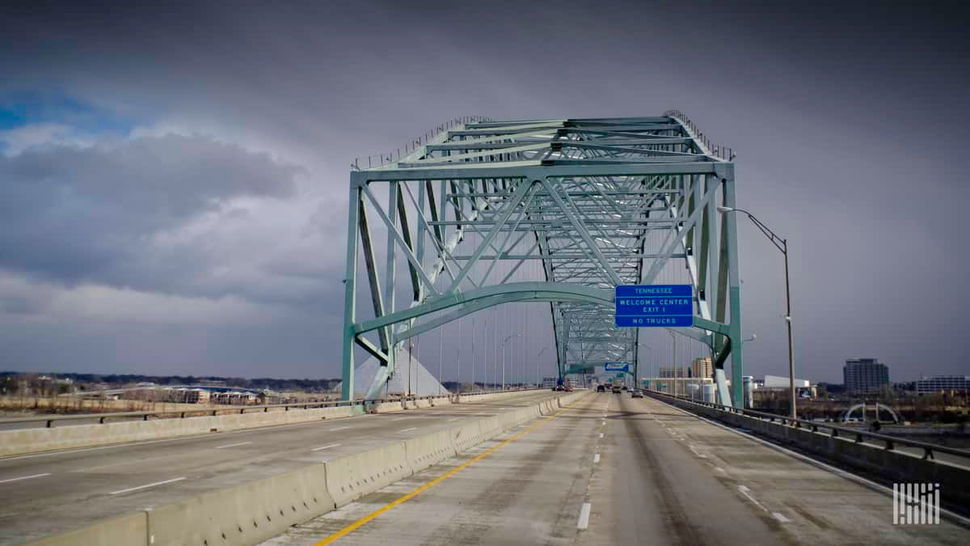

The Interstate 40 bridge connecting Memphis, Tennessee, to Arkansas will remain closed at least several weeks for repairs.
During a May 11 routine inspection of the bridge, an Arkansas Department of Transportation (ARDOT) engineer spotted a fractured beam.

Damage to Interstate 40 bridge between Memphis and eastern Arkansas. Top photo is from May 2019; bottom is from May 2021. (Photos: ARDOT)
The 48-year-old bridge, also known as the Hernando de Soto Bridge, carries traffic on I-40 between downtown Memphis and rural eastern Arkansas. It’s a “vital piece of America’s infrastructure for moving traffic and freight around the country,” as described by Memphis’ WMC-TV. According to transportation officials, the average daily traffic for the bridge was 35,000 to 45,000 vehicles. Trucks made up 25% to 29% percent of that volume.
