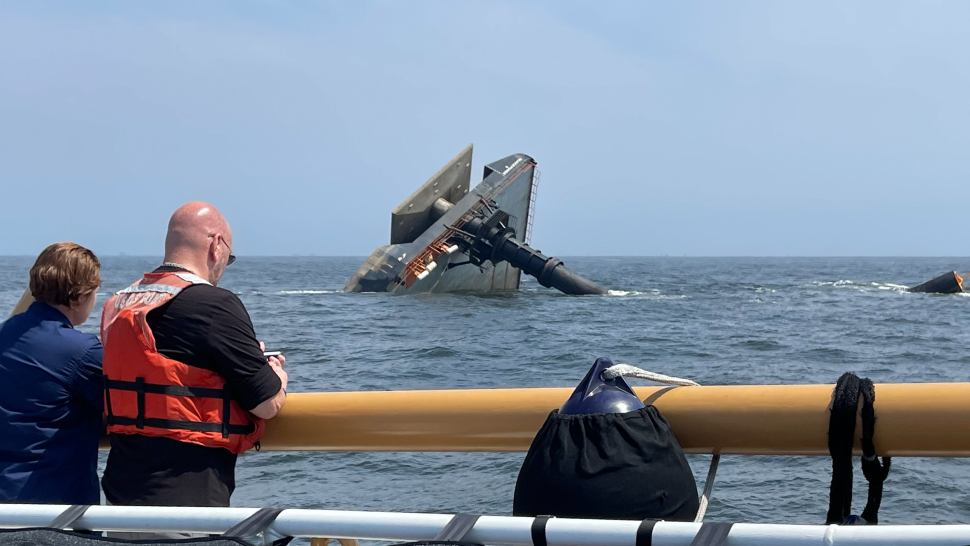

Coast Guard Unified Command team members at the site of the capsized SEACOR Power liftboat in the Gulf of Mexico. (Photo: U.S. Coast Guard)
