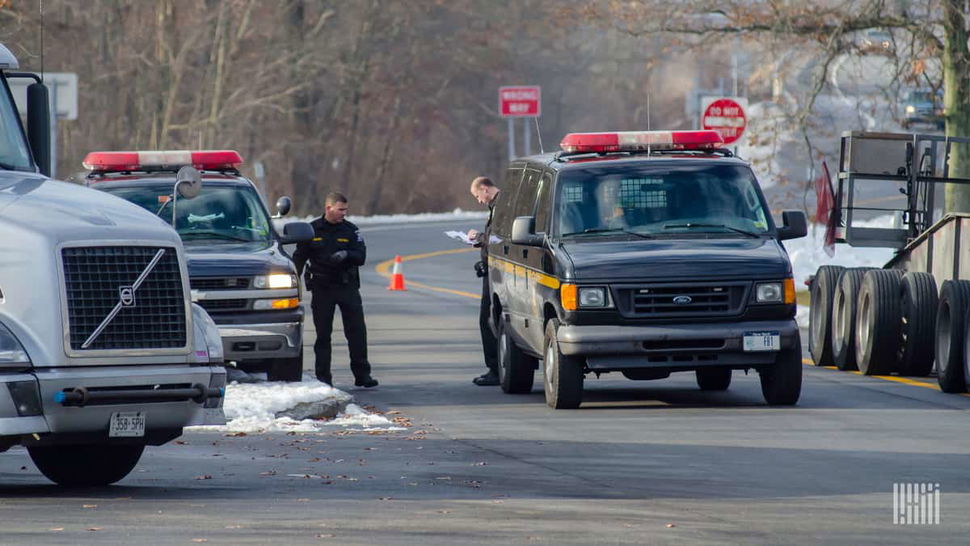

E-log violations during roadside inspections and compliance reviews can add up to thousands of dollars in penalties for carriers. Knowing the most common violations is the first step to avoiding these penalties. (Photo: Jim Allen/FreightWaves)
